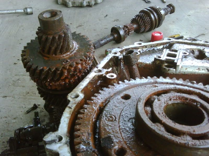

PostSubject: Re: GB charade G100 GTTi   Wed 4 Aug - 9:33
aku br bukak gb yg ada kat aku, result, gb tu gb cb carb turbo.
final gear count 74/15(4.933) tapi aku masih x leh kenal gb tu kalau tak bukak.

PostSubject: Re: GB charade G100 GTTi   Wed 4 Aug - 13:58
ooo kira final drive carb tuh 74/15 ...ler ..

snoop-pie
Number of posts : 54
PostSubject: Re: GB charade G100 GTTi   Sun 8 Aug - 17:58
ya, sori tak perasan ada reply
